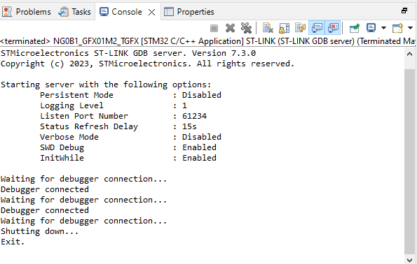

Load failedAnd this photo represents what shown in Console:

I fixed this with myself. If someone need help with the same problem, the answer is here: I was using a code with external memory but without external memory in my hardware. So, the STM32CubeIDE cannot send the rest of pictures for memory.
To fixed this comment the external memory or make sure you have the memory in your hardware.
