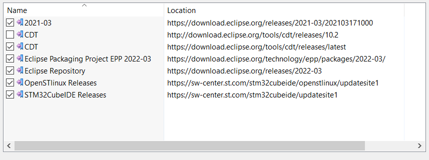

My available software sites under "preferences -> Install/Update" are
What to do to solve this problem?
Please help me.
Thanks Hans

What happens if you force the Reload of STM32CubeIDE Release repository in above prefs page ?
2022-12-02 1:00 AM
Hello Julien,
Thanks for the advice, but the update then aborts with the same error message. The subsequent reload of all repositories does not change anything either. I'm at a loss.

2022-12-02 1:33 AM
If all the reloads worked fine then I don't see other solutions than manually deleting the cache folders
STM32CubeIDE\p2\org.eclipse.equinox.p2.repository\cache
STM32CubeIDE\p2\org.eclipse.equinox.p2.core\cache
STM32CubeIDE has to be stopped for this operation.
You might also have to check that you have well access to the failing plugins through a web browser, just to eliminated the possibility to have any IT softwares preventing access to those URL...
=> Download can be cancelled if begun

2022-12-02 2:00 AM
Deleting these two cache folders dosn't help.
No problems accessing and download the suggested .jar file
Downloading for example the STM32Cube MCU Package for STM32F7 Series 1.17.0 also no problems.
