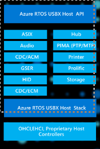

so CDC host from STM is similar to AUDIO host : not useful working.
did someone try the "Azure" host ? seems there are many host types...
https://github.com/azure-rtos/usbx
2023-04-12 2:46 AM
Hmmm, was getting there, but that looks like the perfect solutoin!
Thank you very much!

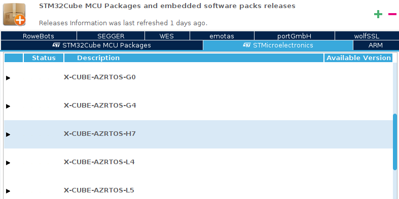

2023-04-12 6:30 AM - edited 2023-11-20 8:52 AM
+ can add in cubeIDE :
2023-04-12 11:48 PM
Thanks again for rthe pointer to Azure,
The H7xx seem to be the most complete
I'm running 746 and 769 discovery boards, and so need to learn a bit more and can probably adapt the ACM driver with not too much effort.
I think most of the config can be done via the config panels in cube ;) and a 'class' for each manufacturer of USB to Serial bridge to get round the enumeration step for 'vendor specific' where class does not come in as 2.
