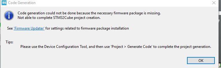

2019-05-28 2:27 PM
Not sure why but now I am getting this message when I try to create a new project to start from scratch, what to do with this one?
