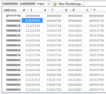

It seems worked perfectly, but I have an offset in my memory Flash.
I should have 0x00 at address 0x90000000 and not 0x01.
I have the same clock configuration.
I don't have the same QSPI memory so I made the modification below :
I tried to modify the writing QSPI function in these example CSP_QSPI_WriteMemory but when I did it the last byte is not written in memory.
I just changed "sCommand.Address = current_addr" by "sCommand.Address = current_addr + 1"
Does anyone use this example to create external loader or has the same error ?
