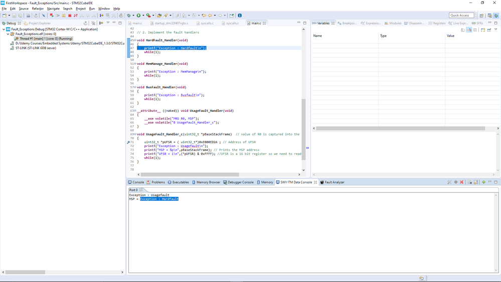

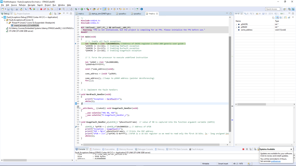

This is the code I am debugging.
This is the problem I encounter. The highlighted statement is a printf statement I have used in the HardFault handler

Cannot re-produce. Here is my ITM console output:
Exception : Usafefault
MSP = 0x2001ffc8
UFSR = 1
