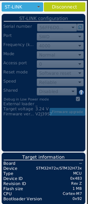

download/install CubeProgrammer ; then connect to target: show, what it tells...
(to find out: can connect etc. )
like here:
