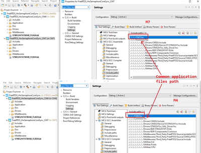

The issue is not very clear to me but according to the examples already provided in STM32CubeH7, FreeRTOSConfig.h file is specific for each core.
For example, in this example https://github.com/STMicroelectronics/STM32CubeH7/tree/master/Projects/STM32H747I-EVAL/Applications/FreeRTOS/FreeRTOS_HwSemaphoreCoreSync
You can find a FreeRTOSConfig.h file in the path \FreeRTOS_HwSemaphoreCoreSync\CM7\Inc and in \FreeRTOS_HwSemaphoreCoreSync\CM4\Inc
And in the include path each project has its own paths:
and there is another folder named Common for common files for both cores.
I don't know if I have answered your question.
