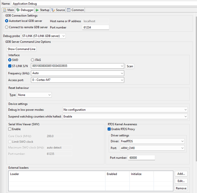

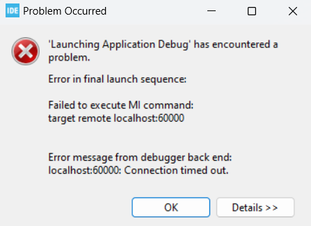

I am working with stm32H755 and FreeRTOS. After setting up debugger, I start debugging the program. the code is built fine, then get this error msg(attached picture) only if i enable FreeRTOS from the setup window(attached picture) . But i need to use freeRTOS. How can i solved this issue?

Settings in STM32CubeIDE1.12.0
error message

OK since it's a custom board you need to check your HW/Schematics based on the HW getting started in this AN: https://www.st.com/resource/en/application_note/an4938-getting-started-with-stm32h74xig-and-stm32h75xig-mcu-hardware-development-stmicroelectronics.pdf
Check mainly the power part and VCAP pins.

Hello @sazzad07 and welcome to the community,
As you are using stm32H755 , be sure your power config is correct SMPS versus LDO which should be inline with your hardware.
What board are you using: custom or ST board?
