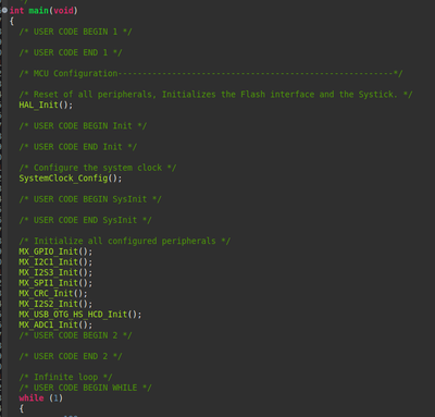

what did you set in the code generator in cube ?
your "main" looks totally wrong - not generated for a cube/HAL stm32 project.
should look like mine here:
so try: make new stm32 project, maybe for F407 - disco board (i suppose, you have this, as i do), change nothing, just generate code. then look, what it looks like...and only write your code between "user code begin...// ...end " comments.
+ printf ... you know, where it should print to? better just toggle a LED as a first test. not print...to nowhere.

Code to enable should be in SystemInit(), that way main() won't fault if you have float or double auto variables in there. Or constructors using floats.
2023-12-17 8:07 AM
The tool settings allow the compiler to generate FPU instructions but you still need to enable it within the code itself.
#if (__FPU_PRESENT == 1) && (__FPU_USED == 1)
SCB->CPACR |= ((3UL << 10 * 2) |
(3UL << 11 * 2)); /* set CP10 and CP11 Full Access */
#endif
