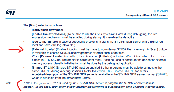

EDIT: I just discovered it works in STM32CubeIDE. With external memory initialize set to disable it will flash it anyway. But it will crash when I enable it. I don't understand the logic of it, but it works! Somehow there are occasional read errors with the flash chip so I reduced the clock speed from 70MHz to 56MHz

Yes. That's what I did. I added the flash loader to the launch file. I have Enable and Init checked.

LOAD 0x008850 0x240c8850 0x081d020e 0x00000 0x00600 RW 0x10000In my launch file I added the external flash loader and set initialize to disable. I can now flash the elf file with STM32CubeProgrammer and I can debug, but not flash the external flash, in STM32CubeIDE.
I get the following error in STM32CubeIDE:

Failed to initialize external memory!
Failed to reinitialize device
Shutting down...
Exit.So it kind of works, but, I wish there is a way to get it working properly.
