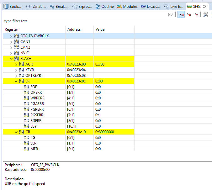

2019-07-16 11:35 AM
SFRs View is missing register descriptions, because the column is missing and it is not possible to add it simply. The description shows up in the details view:

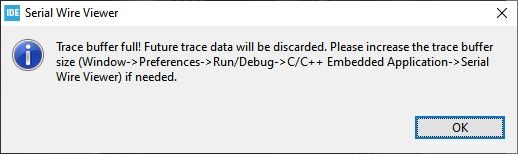

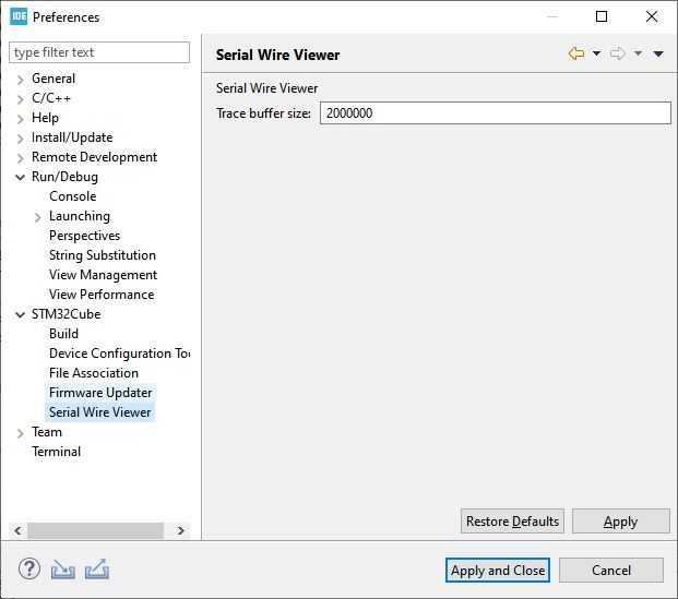

2019-08-12 12:06 AM
I found another bug. The path "Window->Preferences->Run/Debug->C/C++ Embedded Aplication->Serial Wire Viewer" doesn't exist. Right path "Windows->Preferences->STM32Cube->Serial Wire Viewer'
