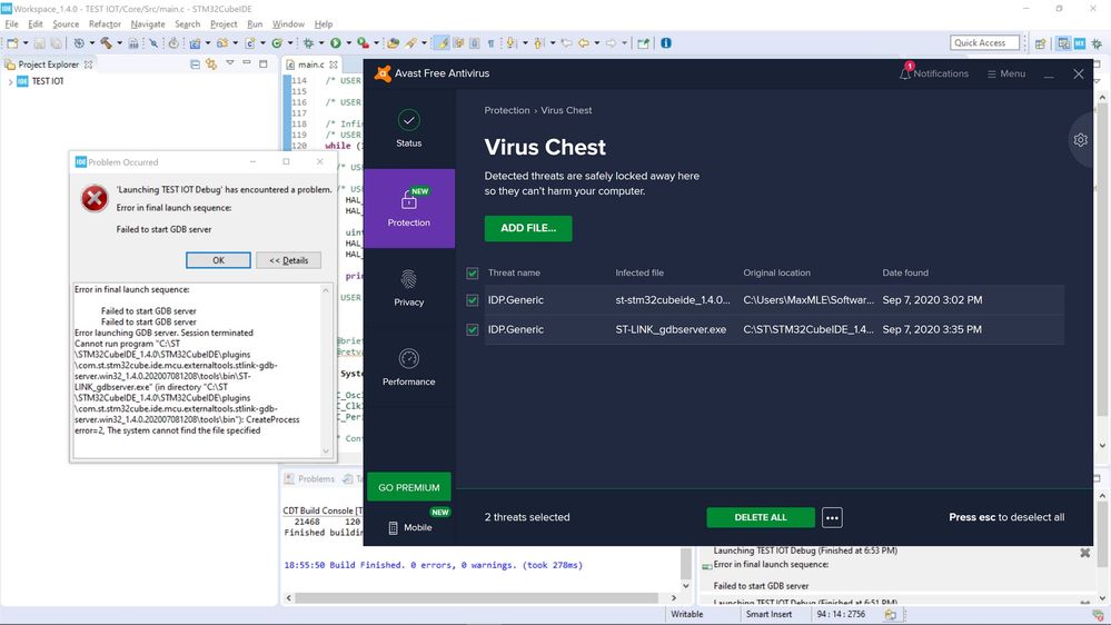

I am getting following error - see picture
https://i.imgyukle.com/2020/09/07/xXWynv.png

I had the "Failed to start GDB server" issue at the second launch of a fresh installation of STM32CUBE IDE 1.4.0
I reinstalled the IDE but it did finish the installation and disappeared... oO'
... Avast ate those files in secret ... -__-
Hope this can help some of you to save time with this issue.
