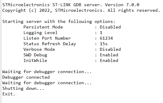

Can't enter into the debug mode on the development branch, but when I switch to master branch I can normally use the debugger. Difference between master and dev branch is minimal, and projects settings and debugging configuration is the same.
I've tried to restart the CubeIDE, clean the project and remove all live expressions, restart the PC, but nothing seems to fix it.

The problem was solved - somehow the debug configuration was overwritten in the other branch which I did not notice at first. The optimization level for the compiler was set None (-O0) and I've changed it to Optimize for debug (-O0). After that change, I could enter the debugger mode without any problems.
The error reported by the CubeIDE was a bit misleading though.
