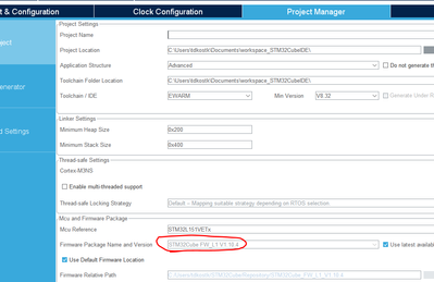

Open your IOC file, go to Project Manager and look at what firmware package it wants to use:

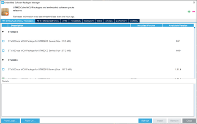

Then go to help -> Manage embedded software packages and download that package.

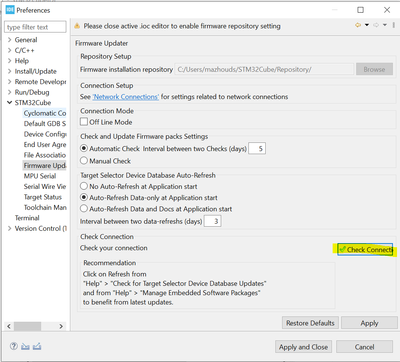

please check the connection (Preference>STM32Cube>Firmware updater)

I tried with check connection, and could observe the same message see in the recommendation window.
I have ensure it is up to date "Target Selector Device Database Updates"; and ensured the software packages is available in the repository.
