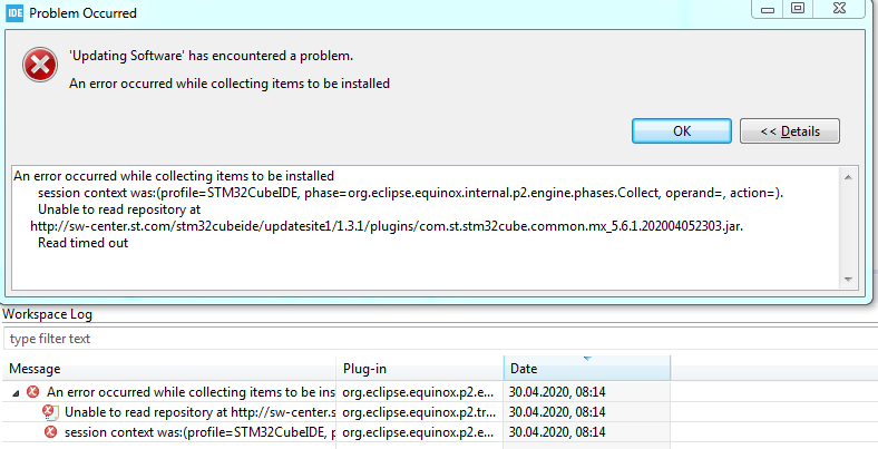

When i try to update STM32, it's give an error and it doesn't update.
An error occurred while collecting items to be installed
session context was:(profile=STM32CubeIDE, phase=org.eclipse.equinox.internal.p2.engine.phases.Collect, operand=, action=).
Unable to read repository at http://sw-center.st.com/stm32cubeide/updatesite1/1.3.0/plugins/com.st.stm32cube.common.mx_5.6.0.202002181639.jar.
Read timed out
Unable to read repository at http://sw-center.st.com/stm32cubeide/updatesite1/1.3.0/plugins/com.st.stm32cube.ide.mcu.externaltools.cubeprogrammer.win32_1.3.0.202002181050.jar.
Read timed out
Unable to read repository at http://sw-center.st.com/stm32cubeide/updatesite1/1.3.0/plugins/com.st.stm32cube.ide.mcu.externaltools.jlink.win32_1.3.0.202002181050.jar.
Read timed out

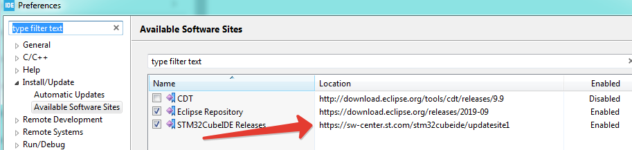

2020-04-29 8:06 PM
Replaced
https: //sw-center.st.com/stm32cubeide/updatesite1
on the
https://sw-center.st.com/stm32cubeide/updatesite1
and the problem was solved

2020-04-29 5:22 PM
Hi, I’ve been trying to update for 10 days!
Unable to read repository at http://sw-center.st.com/stm32cubeide/updatesite1/1.3.1/plugins/com.st.stm32cube.common.mx_5.6.1.202004052303.jar.
Read timed out
what to do to get an update?
2020-04-29 8:06 PM
Replaced
on the
