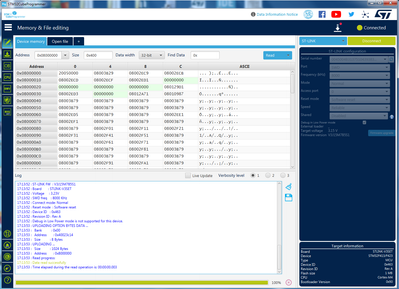

2025-03-31 1:17 PM
Thanks for the reply
Yes, I forgot to add that I also updated the STLINK-V3 firmware
I used CubeProgrammer and had no errors:
2025-03-31 1:54 PM - edited 2025-03-31 1:54 PM
Good,
so it should work in IDE also. Just set same ...(set connect: normal, software reset)
because obvious: st-link and your cpu ok, can connect. So just the settings in IDE could ... be not so good.
