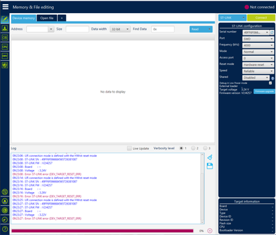

2023-11-16 12:06 AM
This is error log
2023-11-16 12:21 AM
Please upgrade STM32CubeIDE 1.11.2 and STM32CubeProg to the latest version. It would also make sense to update the firmware on the ST-LINK/V2, which you can do from the CubeProg, alternatively via the CubeIDE.
2023-11-16 4:25 PM
I update the STM32CubeProg, but same error.
What point do I have to check, H/W?
