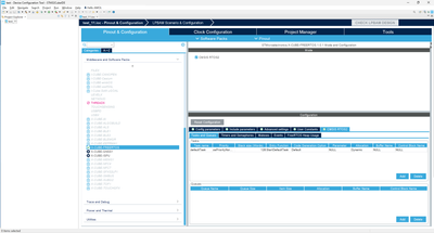

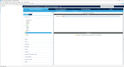

I am creating project using STM32CUBEMX for board (B-U585I-IOT02A) Non-Trust-Zone.
the above configuration done while creating project.
I am getting stuck at HardFault_Handler.
am I missing some configuration, please let me know !!
