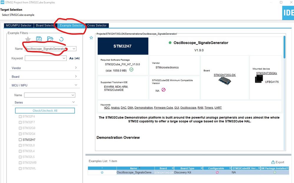

Just in case could you get a new try relying on File > Import > General > Import STM32Cube example
Let us know if helping or leading to same trouble.
