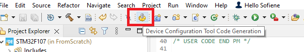

2024-09-26 8:02 AM
@MDe wrote:
You still do not explain me why, at some point, we need to install a second application, STM32CubeMX and generate code through it, for it to work ?
I didn't tell you at any time you "should" install STM32CubeMX.
There are two possibilities:
1- You start from CubeMx (the standalone) tool and configure your peripherals and generate your code from there. In this case you need to generate the code with this button:
2- Start from CubeIDE tool (as stated in UM2609 / section 2.1.2 Creating a new STM32 project) and use the integrated CubeMx in CubeIDE. In this case you need to generate the code with this button:
Hope it's clear now.

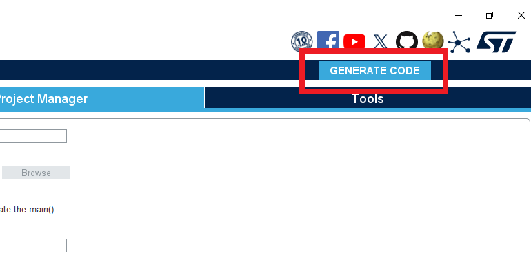

Hello @MDe ,
You need to generate the code by clicking on [GENERATE CODE] button in CubeMx:

2024-09-26 4:39 AM
Previously you didn't attach your CubeIDE project. You shared just the ioc file.
I've just double clicked on Bal.ioc file to open it with the standalone STM32CubeMx tool downloadable from here then generated the code as described previously.

Againg you didn't share this CubeIDE project file:
This is what you shared in the zip file: only ioc file is present here:
Now, as I said previously, please open the ioc file using the standalone STM32CubeMx tool downloadable from here and generate the code using this button:
