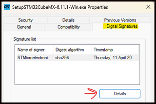

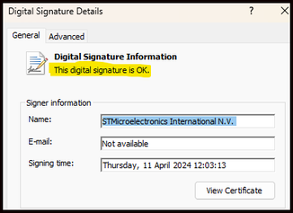

Full installers (.exe files) for Windows are signed and Windows itself can verify the signature:
So this is all the user wants or needs.
OS/X packages have similar signatures. Linux - not sure.

Thank you Pavel. I guess that is sufficient.
Unfortunately the x.x.0 versions are usually not usable - e.g. 1.15.0 breaks the debugger and other stuff, but ST are keeping only these x.x.0 versions on their website, and only for a while. So I would have to archive the one I want to keep, and rely on the signature.
