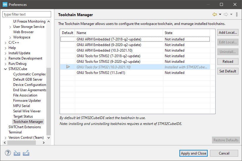

2023-03-07 11:49 PM
I suppose you would be interested by the toolchain-manager available in Preferences > STM32Cube:

2023-03-08 12:13 AM
Didn't know about that setting. Thank you.
