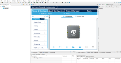

It looks like something is wrong with target selector/board selector when i click to choose the board seems application is not choosing any board and just directing me to next step which i showed on photo , also on the left side in board selector it dont displaying any pinouts of cpu/board

hehe exactly i did press next , and after pressing i have option to choose targeted project type > empty only not stm32cube
2021-09-02 3:17 PM
You press next twice, then finish. If that's not working, show a screenshot of the page that isn't working for you.

I did updated all of packages like you say but i still facing same problem.
Just after loading manually packages for my board the device configuration manager finally started... so thanks for help
but it is weird why it doesnt functioning after downloading packages via cubemx
Regards
