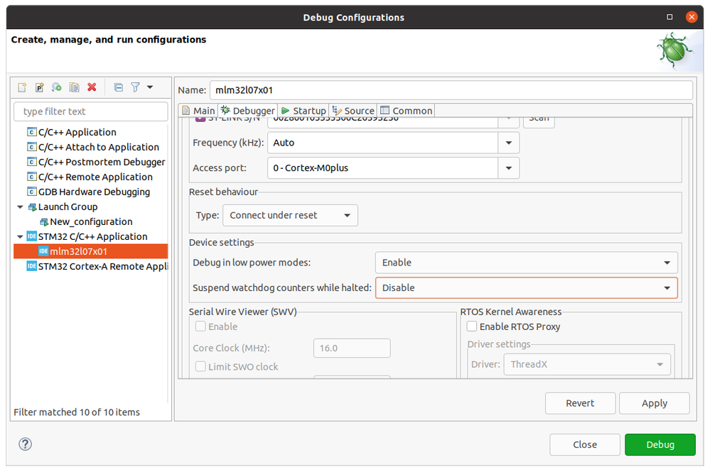

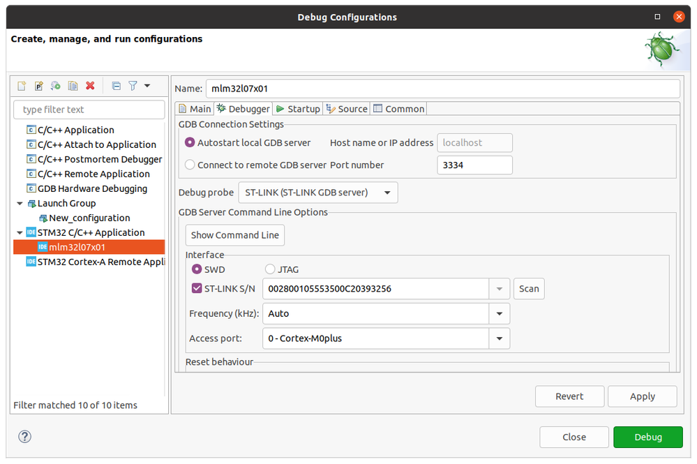

I've developed a program using the I-CUBE LRWAN package, but I'm having a problem debugging it. Here is the configuration I used for debugging:
The errors I'm encountering are as follows:

Do you have any ideas on how to solve this problem?
Thanks in advance for your help!

Check powering jumpers. Try to connect Under reset mode.
Hope this helps.

I did that, but the same problem persists.

Make sure to upgrade your ST-Link firmware and using latest release of tools.

Makes sure the code isn't purposefully disabling or reconfiguring the SWD pins.
Disable the firmware from sleeping the MCU, and turning off power to the debug circuits.
