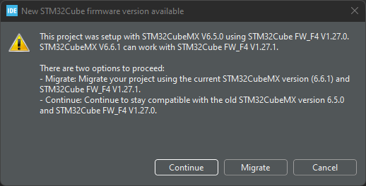

I should note that this project was generated using TouchGFX 4.20.0, and this is the warning I always get when I open the IOC file. I saw on another post that you never should Migrate to the latest version, just stick with the version that you are given, so I always choose Continue.

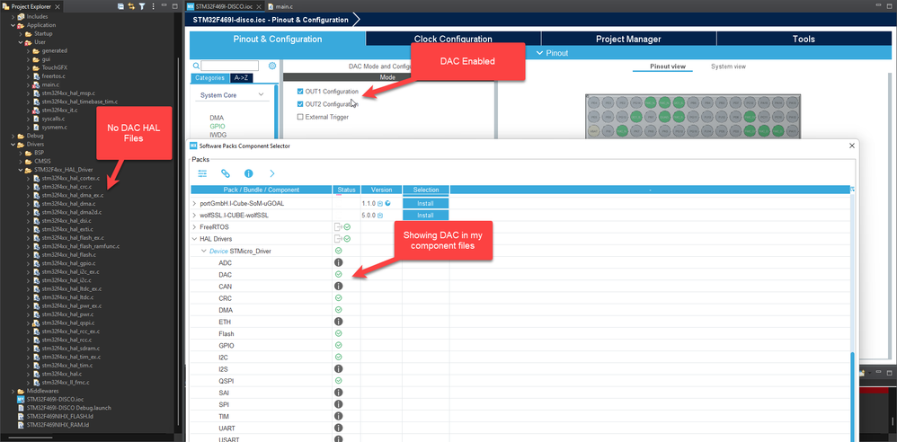

2022-08-24 2:34 AM
Also, here is what I am visually seeing in my project with the IDE:
