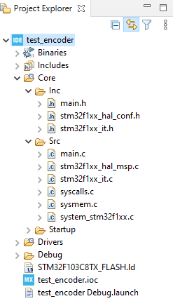

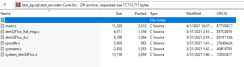

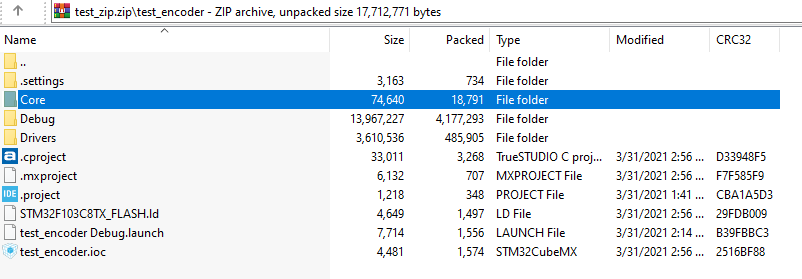

Can you be more specific? I use CubeMx 1.6.0 and the installed CubeMX 6.2.0 RC3 and I follow what you did. I mean I try to export in a zip archive one of my opened projects. I check to be all the folders marked and then I archive them. After that, I check the newly made archive and everything was there (.c files, .h files etc.).
Really I do not understand what are you guys trying to do?
Example given:
My project
0693W000008yyCiQAI.pngExported archive:0693W000008yyCxQAI.pngSrc folder content:0693W000008yyDRQAY.pngInc folder content:0693W000008yyDlQAI.pngAll of them are identical with coresponding files in my project. So, no problems at all.
