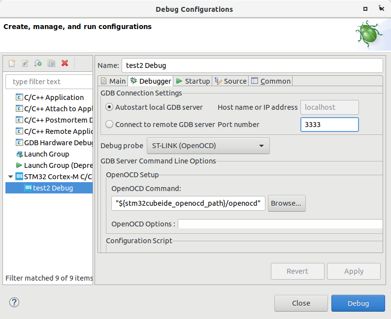

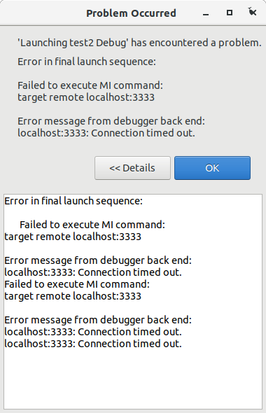

2020-06-27 2:05 PM
Thanks for you advice! I set up debug configuration that you can see below and saw a bunch of errors. I really want to know what I did wrong
2020-06-30 7:04 AM
@Community member is right. This is a very old board. Probably the only board embedding the ST-LINK/V1. ST-LINK/V1 is not supported by CubeIDE.
Would recommend to get another board. A possible option could be to use external debug probe and connect it on the 4-pin SWD header. Works on other Nucleos/Discos. But a new board is certainly a better solution.
