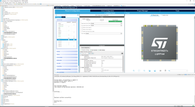

I have found a strong isssue in:
STM32CubeIDE
Version: 1.15.1
Build: 21094_20240412_1041 (UTC)
(C) 2024 STMicroelectronics ALL RIGHTS RESERVED
The IOC configurator for the STM32H755 lacks an option in the RCC configuration
Power Parameters -> SupplySource
The PWR_DIRECT_SMPS_SUPPLY setting is missing.
This setting is required for the NUCLEO-H755ZI-Q board which default supply configuration:
the SMPS feeds the core without using the LDO.
Regards.

2024-05-24 8:40 AM
Hello @zeboss49
I'm not able to reproduce this, everything works fine here using
STM32CubeIDE
Version: 1.15.1
Best Regards.
STTwo-32
2024-05-24 10:08 AM - edited 2024-05-24 10:09 AM
your screen shot is from 1.14.1 not 1.15.1.
The attached screen shot to my original post shows that the item is missing.
I upgraded to 1.15.1 form a rather old version because the IOC has strong issue rendring the H755 configuration (blank screen).
Then I created a project for the Nucleo board and got a warning saying that the power option (SMPS DIRECT) was not valid.
Do you suggest that I should fully remoce CubeIDE and do a fresh install ?
In this case, is backuping the workspace, clearing the folder, installing a fresh copy and restoring the workspace form the backup a safe solution?
Thx

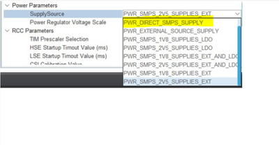

2024-05-24 10:14 AM
the latest version of CubeMX does show the option.
2024-05-24 10:20 AM
I'm using the V1.15.1
Here is the option you are looking for on your own screenshot:
Best Regards.
STTwo-32
