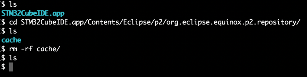

Hi MKeff.1,
Did you tried to apply the workaround, aiming to cleanup the updater cache, already shared on the Forum?
Regardless the update issue, be aware that STM32CubeIDE is not fully compliant with Big Sur.
HTH

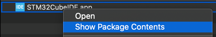

Hi Julien, no I didn't try that already. I did look before asking but I didn't see the post you refer to.
I closed CubeIDE and looked for STM32CubeIDE.app which I found in Applications (makes sense!). I cannot open it though to navigate further to STM32CubeIDE.app/Contents, if I open it it just starts the app. So I don't understand your instruction number 2.
It sounds like I should just stick with my current version though based on what you said! So I will stick with v1.5.1 for now =)

2021-04-28 7:26 AM
Indeed, to access deeper into an .app you either have to do it thanks to "Right click > Show Package Contents" or using a Terminal.
Not fully compliant with Big Sur means that you might face some troubles. Anyway we don't expect more issues with 1.6.1 than you could already have with 1.5.1. Both versions are based on the same Eclipse platform.
