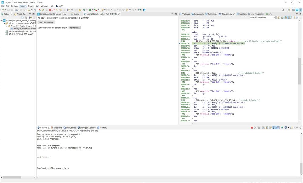

I was making a project with CUBE IDE and compiling it on the board, and I got this error while compiling the project I was doing on the new board.
No source is available for "Call Signal Handler"() in 0xfffffffe.
I'm sure they're using the same CPU
I can't compile it because it's STM32 ST-LINK
I don't think there will be any problems with the code or MX settings because if I modify the code on the existing board, the project will also change well.
Even if I create a new project and add the above code, I get the same error, so I can't compile it
I want to solve this phenomenon, how do I solve it?

The same error occurs in the above simple code.
How can I fix this problem?
Note that this is not an error that you'd get while compiling: this is a runtime error - it means your code is crashing while it's running on your board.
That makes no sense. What do you mean by that?
Again, the message has nothing to do with compiling.
Does the code build cleanly - ie, with no errors and no warnings?

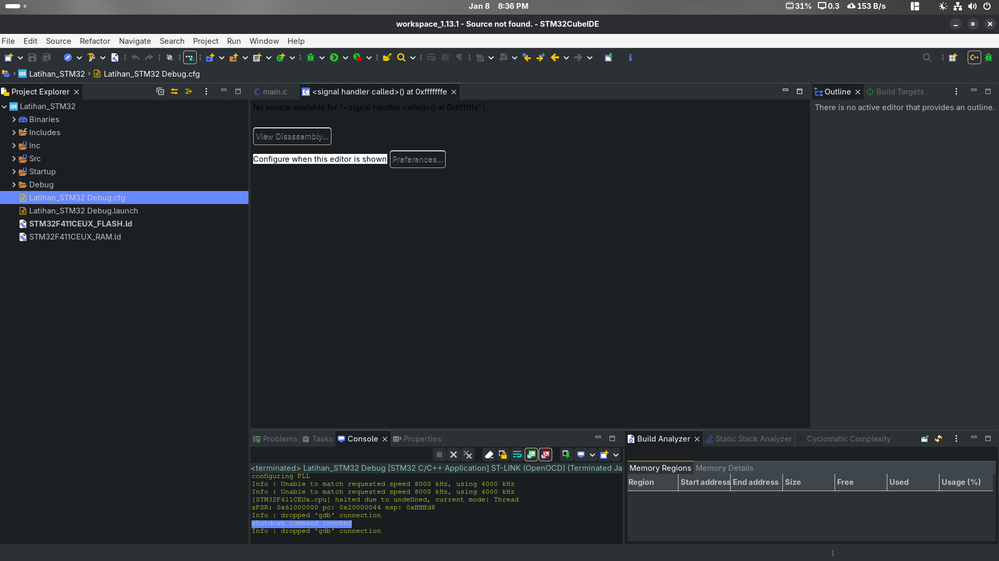

I'm experiencing the same thing.
But mine can execute the code and experience changes in my MCU, such as LED blinking, and there are no error messages at all.
Is this a problem or is that how it works?
What is this usually called?
