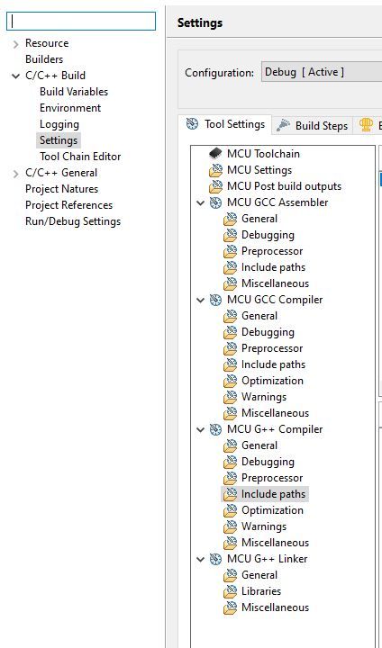

We are still seeing issues finding the include <new>:
rm-none-eabi-gcc "../src/main.c" -mcpu=cortex-m0 -std=gnu11 -g3 -DHSI_VALUE=8000000 -DSTM32F030 -DUSE_STDPERIPH_DRIVER -c -I../src -I../Libraries/CMSIS/Include -I../Libraries/CMSIS/Device/ST/STM32F0xx/Include -I../Libraries/STM32F0xx_StdPeriph_Driver/inc -O0 -ffunction-sections -fdata-sections -Wall -fstack-usage -MMD -MP -MF"src/main.d" -MT"src/main.o" --specs=nano.specs -mfloat-abi=soft -mthumb -o "src/main.o"
../src/main.c:22:10: fatal error: new: No such file or directory
22 | #include <new>There must be something basic about the project/workspace configuration for a mixed C/C++ STM32 build. Anyone running a mixed C/C++ build in Cube IDE?

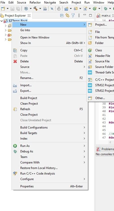

If you have a C project: right click on the project and select "convert to C++".

The original project is pure C but the new stack we need to use is pure C++. The project pull down has no convert to C++. If we move object creation calls to a .cpp file, what would be a good way to reference C++ objects from a main.c or any other C file?
2023-03-29 8:35 AM
We found that the first part of the problem was not using a "C" extern definition on the calling function in the interface .cpp file.
extern "C" uint8_t testCompile(void);Once this definition was in place the main.c file could see the function. At this point the option to convert the project to C++ appeared. Once the conversion was complete the C++ compiler option appeared in the project settings and everything build correctly.
