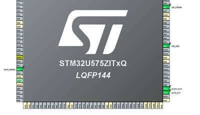

3. pinout view is like this
well.. I think master configuration could be the problem... but I'm not sure

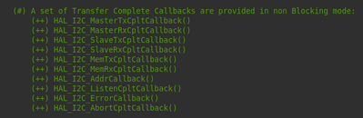

Just question : why you use INT call - if you anyway wait , until finished ?
HAL_I2C_Master_Transmit_IT()
why not blocking then:
HAL_I2C_Master_Transmit(..)
Would be better...it waits "auto" until finished. (Same for receive.)

Maybe...but useless, if you wait for finished. (And : sure its finished, if tx empty ? It might still shift out last bits from shifter, but you do not wait for this. Did you proof , that all transfer finished and I2C stop done ? )
If using INT function, you have to use the INT , that tells you : finished now.
And "if the system have complex parallel functions" its the right way - but only if you not wait for finished, but do many other things in the time of transfer;
But if anyway need waiting, because communication is this way, use blocking function. Not more slow, same speed.
