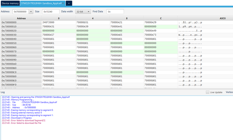

I can compile the program without error, but the download will fail. I tried using the STM32CubeProgrammer, but I got the same results.
Here is a screenshot from the download in the programmer:
I'm not 100% sure, but it looks like it ties to writing my byte buffer into the flash memory instead of 0x90000000.

2025-02-11 7:24 AM

This looks OK, and nothing suspicious seems to be in that code. Still, for some reason, it is not possible to download it to the processor. You can use the STM32H7S78-DK to test the download. Regarding the memory, it's very similar to my board.
Look, @KnarfB, I've been on this planet since 1964 and have worked with several processors and compilers. My first processor was an Intel 8051, and it was a beauty. After I finished my time at the University, I had the pleasure of working with a team of brilliant people who developed a controller using a Motorola 68HC11. That chip just hit the market, and I learned a lot. The machine code at this time was not as complex as it is now, but still tricky. I'm surprised that the modern compiler still stores address values in lookup tables in some arbitrary memory areas.
However, one has to use the tools available. English isn't my native language, and things get bungled up sometimes. I'm trying to say that the STM32CubeProgrammer is trying to load the code into the FLASH address range and encounters an issue when attempting to write something to Segment[1] in this example.

2025-02-11 9:34 AM
well, the first computer I had access to in the 70ies read the machine code from a punch tape and stored it on a magnetic drum...
Try the following:
.user_psram_sec (NOLOAD) :
/* ----- USER_PSRAM_MEM_01 - 10240 Bytes ----- */
. = ABSOLUTE(0x90000000);
*(.USER_PSRAM_MEM_01)
/* ----- USER_PSRAM_MEM_02 - 40960 Bytes ----- */
. = ABSOLUTE(0x90002800);
*(.USER_PSRAM_MEM_02)
/* ----- USER_PSRAM_MEM_03 - 10240 Bytes ----- */
. = ABSOLUTE(0x9000C800);
*(.USER_PSRAM_MEM_03)
} >USER_PSRAMwhere NOLOAD indicates that the downloader should ignore it.
You may use the following command for .elf inspection:
arm-none-eabi-readelf -e C:\tmp\STM32H7R3L8H6H-Sandbox\STM32H7R3L8H6H-Sandbox\Appli\Debug\STM32H7R3L8H6H-Sandbox_Appli.elfhth
