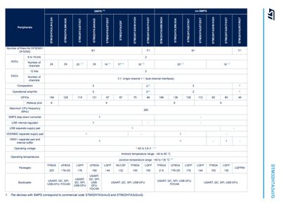

COMP2 is not listed on the configuration tool... eventhough it is well documented on the RM0455.
Please provide directions to activate and use properly COMP2 on the H7A3

Hello @GMate.11
As you can see on the DS13195, the STM32H7A3RIT6 provide only 1 Comparator (last column of the following screenshot):

Hello @GMate.11
