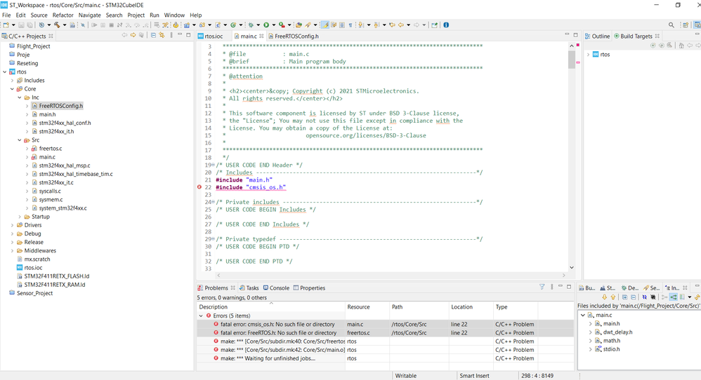

i was watching this tutorial:
https://www.youtube.com/watch?v=OPrcpbKNSjU

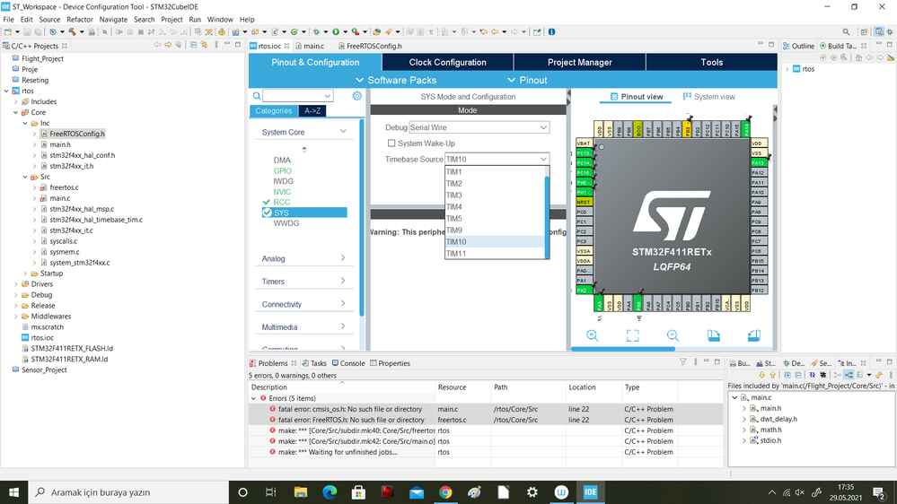

Differences between video and what I do:
my card is stm32f411re nucleo64 and i select the tim10 because the tim6 was not visible to me
these are pictures:

Welcome to STM32 Community!
Please check the include Paths
==> Go to Project options ->C/C++ tab->Include paths and add new paths to your include directories
Imen

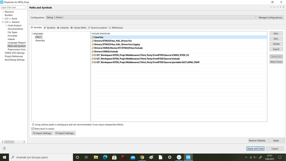

2021-06-04 2:00 PM
hello, thanks for your reply, sorry for the late reply, as you said, I checked the included paths from the project options and as you can see in the picture, I added three new paths and the errors I got were resolved, but this time other errors appeared.

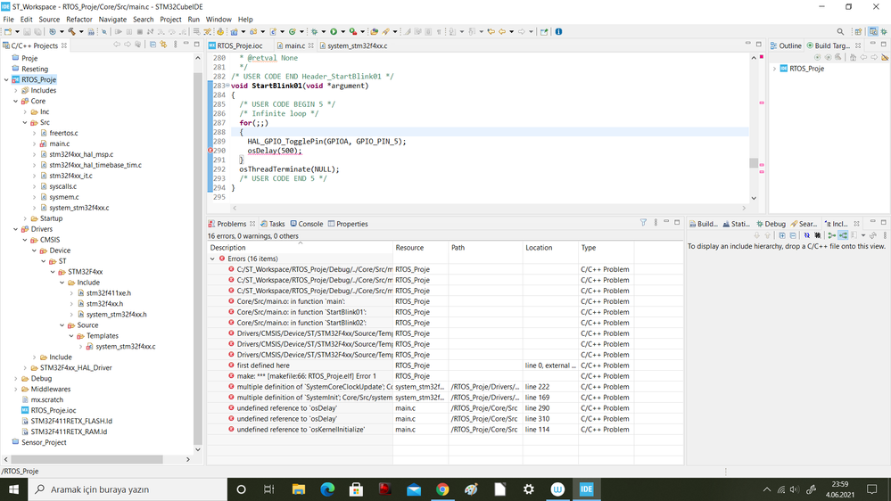

this is the file config i made
these are the new errors i got
2021-06-04 2:03 PM
I checked the undefined reference errors about stm32 on the internet but I couldn't find anything useful
and sorry for my bad english
2021-06-05 1:59 AM
Well, then learn using the Internet first... The "undefined reference" error means that there are no actual function implementation, which typically means that the corresponding *.c files are missing or not compiled.
