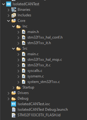

2024-04-12 5:18 AM
This is the folder structure of the project. The main.c file in the Src folder is the one that is not getting updated.
Also, thanks for the advice on CAN configuration, I was already having issues with CAN's reliability, I guess it was because of this configuration.
