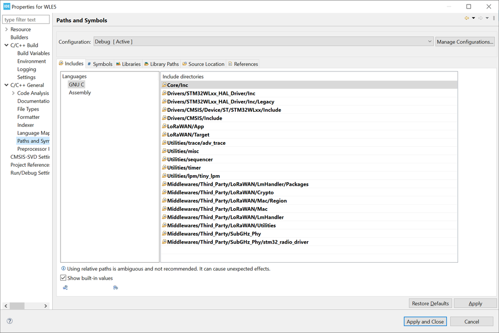

I want to change the path for where the STM32CubeIDE writes the source code files generated when the .ioc file changes.
I am using STM32CubeIDE Version: 1.12.0.
Is it possible, and if so, how?

Hello @SS13 ,
You can customize the project as you wish, putting resources in locations as desired through the project settings:
But you need to understand how Eclipse works in order to not mess things up, so a link to this could be helpful:
https://www.eclipse.org/escet/use/projects.html
Don't hesitate to ask more questions !

Hello @SS13 ,
Do you mean that you need to edit the path of source folder ?
waiting your response !

Yes. By default the source code is created in a "Core" folder. I won't want my project structured this way.

Hello @SS13 ,

2023-03-31 12:22 PM
Yes. That link is helpful.
