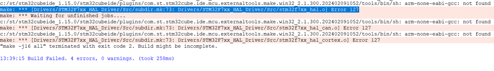

When I build a project, I get the errors "c:/st/stm32cubeide_1.15.0/stm32cubeide/plugins/com.st.stm32cube.ide.mcu.externaltools.make.win32_2.1.300.202402091052/tools/bin/sh: arm-none-eabi-gcc: not found" and "make: *** [Drivers/STM32F7xx_HAL_Driver/Src/subdir.mk:73: Drivers/STM32F7xx_HAL_Driver/Src/stm32f7xx_XXX.o] Error 127"(XXX is the name of the file.) in the CDT Build Console for no apparent reason.
The number of these errors changes each time I build, making it difficult to identify the cause of this problem. No matter how many searches I did, I could not find anything, and when I checked with my colleagues, no one was aware of these errors. Can someone please help me with my biggest question.

These errors occur during the process of generating code and writing the program.
A program that worked 5 minutes ago may suddenly get this error.

Probably the multi-threading -j option, things didn't complete, parts left unbuilt.
