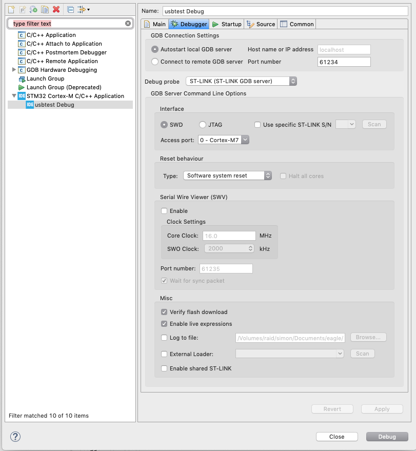

2019-10-22T10:39:38 INFO: Flash written and verified! jolly good!The debugger configuration looks like:
Any hints ?

Hey, I had the same issue and resolved it by setting Debug Configurations -> Debugger -> Debug probe = ST-LINK (OpenOCD)
2019-11-21 2:43 PM
I can confirm: changing `ST-LINK (ST-LINK GBD server)` to -> `ST-LINK (OpenOCD)` does work!!!
