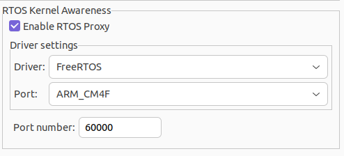

Having an issue trying to view multiple thread contexts with CubeIDE RTOS kernel awareness. The debugger keeps disconnecting when RTOS kernel awareness is enabled
Normal debugging using GDB server is function correctly.
Upon enabling RTOS Proxy, after startup pausing the debugger results in the following error being printed to the console :
Update threads. Failed collecting threads
Followed by:
Lost connection to GDB Server
Proxy stopped.
and then the debugger is disconnected.
Full Console Log:
STMicroelectronics RTOS Proxy. Version 0.9.2
Copyright (c) 2021, STMicroelectronics. All rights reserved.
Loading RTOS driver... FreeRTOS
Connecting to GDB server on port: 61234 ... Connected
Listen for GDB connection on port: 60000 ... Connected
Failed reading: xList.pxNext.pwOwner
Update threads. Failed collecting threads.
Proxy stopped.
FreeRTOS Version: "V9.0.0"
Processor: STM32H7
