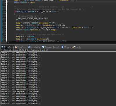

I was working on my stm32f411re nucleo boards. i was using two of them with spi full duplex mode one as the master and the other one as the slave. I was working on my codes and at a certain point when i tried to debug one, it asked me to upgrade my st-link and i upgraded. then, all of a sudden i wasnt able to debug my stm. The occuring error is like;
I connect my STM -> I start Debug -> it builds, loads, verifies -> It stopts at HAL_Init() function as always -> when i start F8(continue) it gives the following error

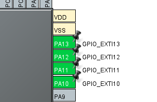

I am getting an error inside the function HAL_GPIO_Init(GPIOA, &GPIO_InitStruct);. I am using 4 PA pins as external interrupt which are ;

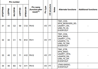

and while the functions loops for initializing the pins one by one, it gives an error at PROBABLY pin PA13 and after seeing that i decided to check the datasheet for stm32f411re and saw this;
i think it is about JTMS-SWDIO function up there in the PA13. And the exact line i get the error is this ;
GPIOx -> MODER =temp;

*** QUICK UPDATE ***
I removed the pin PA13 from my project and it debugs perfectly well... So I want to know why it creates a problem and why the application does not gives a warning about this i want to know the reason.

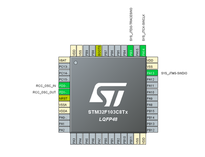

define in Cube at first these important settings, then you cannot use pins for other things and spoil the function of the cpu.
When you set this first :
So you have a basically working cpu with debug (and swo here) and NOW set other functions as you like... :)
