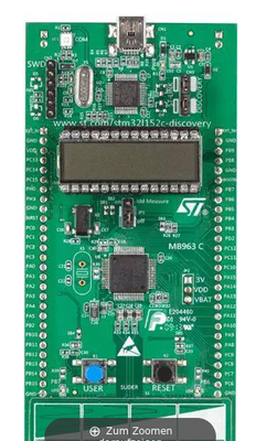

2023-06-28 10:13 AM - edited 2023-06-28 10:13 AM
so buy a cheap disco board, to make some first programs and see them work (or not :) )
12,38 €
