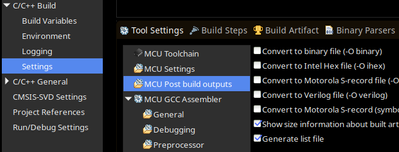

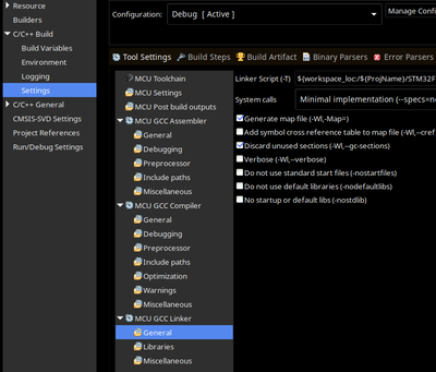

2024-07-01 5:52 AM
check : generate map file.
show size + list file
here from IDE 1.13.1 ; or 1.14.1 - same.

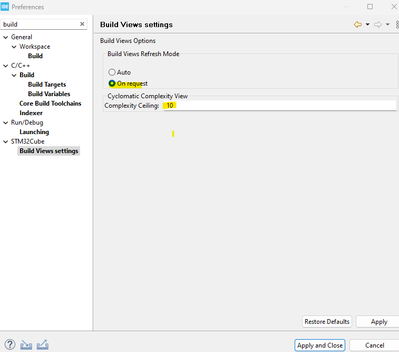

2024-07-03 7:08 AM
Hello @Gianni7315 ,
Could you try selecting the 'On request' option in the Build Views Settings. Then refresh the Build Analyser view using the 'Refresh' button, wait a while and the information will be displayed.
Thanks,
Rim
