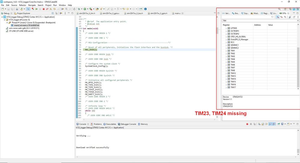

In STM32CubeIDE versions 1.5.0 and 1.6.0 missing SFRs TIM23 and TIM24. Project created for STM32H723(ZG) .

Hi @Michal Dudka ,
Please find attached the updated svd file.
It will also be integrated to STM32CubeIDE.
-Amel

Hi @Michal Dudka ,
I confirm the issue you are reporting.
I highlighted it to our development team who will take care to add remaining registers.
Thanks,
-Amel
