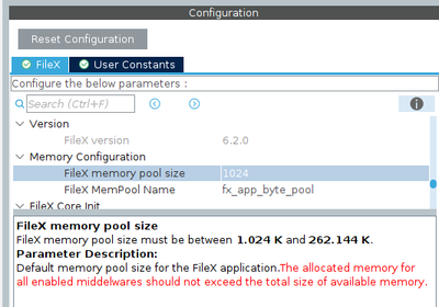

Bug in CubeIDE/MX for STMH563 -> Filex : wrong size shown

looking at the size for pool, stack etc , Filex /Azure rtos , its a bit too much :  1024 K - should be : 1024 Byte

Might be a localization issue. Note the period. Here in the US, 1.024 K = 1024 bytes. It's a poor way of writing it, regardless. Should be 1K or 1024.

right, i didnt think on this us style -> 1 GB = 1,000,000,000 (109) bytes ; comma vs. dot :)
