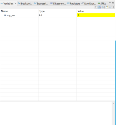

Hello @nico23
I've personally tested using the STM32WB55-NUCLEO and the STM32CubeIDE V1.14.1 and this simple code:
/* USER CODE BEGIN 1 */
int my_var;
__NOP();
my_var = 0b01;
/* USER CODE END 1 */
And that works fine (even without the __NOP() ) and set the my_var to 1 as you can see:
Could you give more details about your issue.
Best Regards.
