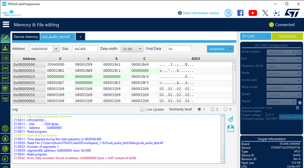

When I ran the program with STM32CubeProgrammer, I still got this error.
Error: Data mismatch found at address 0x08000000 (byte = 0xFF instead of 0x00)

I had the same issue. The solution for me was doing a full chip erase before programming as described in the link below.
In my case it was only happening when I was using STMCubeProgrammer and not in the STM32CubeIDE (v 1.15.1). Maybe if I updated to your version of the IDE it would fail there too.
https://community.st.com/t5/stm32-mcus-embedded-software/data-mismatch-found-at-address-0x08001000-byte-0xff-instead-of/td-p/645723
