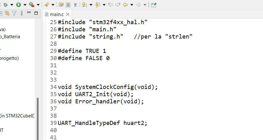

I've just updated STM32CubeIDE to version 1.11 and the labels are no longer coloured (green comments, purple "void" etc.) and I can't even find the hammer-shaped "build" button at the top to check if the code is working.
By the way, during installation of the update (performed by clicking 'help'-'about stm32' - 'installation details' - 'update') a pop-up appeared warning me that some installation files had an unknown source and asking me whether to proceed or not
Furthermore, I can no longer even create a project as I have always done with previous versions 'file'-'new'-'project' creates a simple empty folder without even allowing me to select the MCU etc.
