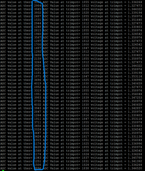

2023-12-18 2:27 AM
Hello @TDK Thanks for solution.
I have another problem.
In one of channel the ADC values are shifting drastically i have checked voltage going to controller is correct (1.89v)
but I'm not getting desired output whereas another channel values as per input voltage.
please check the snap attached how the values changing in 7th channel.
what can cause this problem?
2023-12-18 6:24 AM
How is that channel connected? What is the desired output you're expecting?
See here for general ADC accuracy tips:
In particular, sampling time can increase accuracy for high impedance signals.
Connecting that signal to GND and verifying ADC output is near 0 can also help to double check that it's connected correctly and that the pin is initialized properly.
